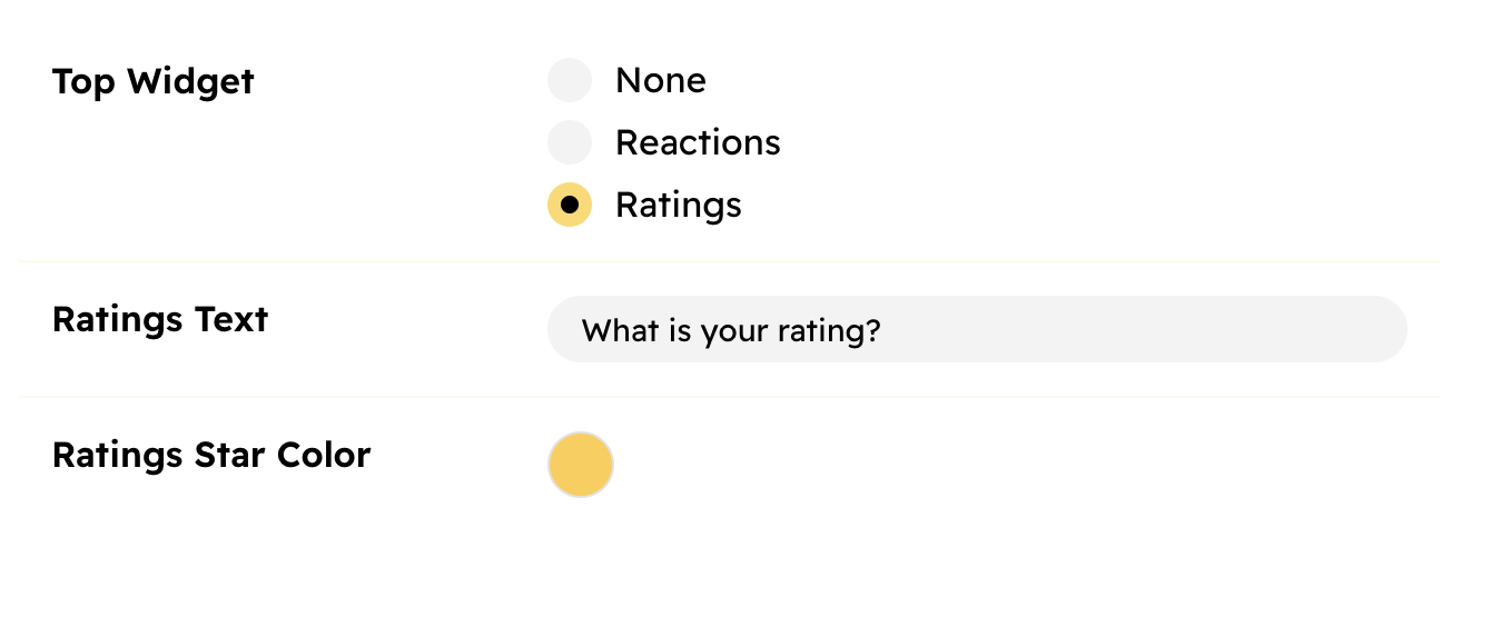

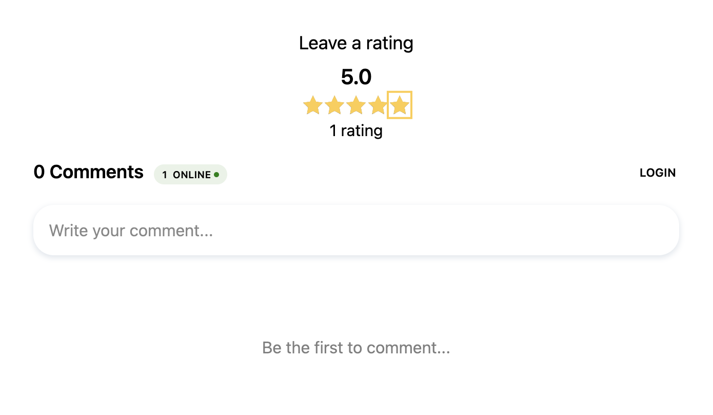

The ratings widget comes with the comments section. It allows visitors to leave a rating for the page. It will be displayed above the comments section.
You can configure ratings widget at Console → Settings → Reactions & Ratings.

In this code, we use the loaded event of the <hyvor-talk-comments> element. It is fired when the comments are loaded. Then we get the page data using the api.page() method. Then, the following values are used to generate the JSON-LD code:
page.ratings.average - Ratings average of the page.page.ratings.count - Number of ratings for the page.Then, we create a <script> element with the JSON-LD code and append it to the <head> element.
